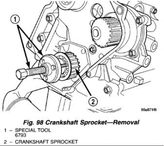

It can be done at home but its not gonna be easy-see below REMOVAL Disconnect negative cable from battery. Remove Timing Belt. Remove Oil Pan.
https://images.2carpros.com/forum/automotive_pictures/12900_o1_2.jpg
Fig. 98 Remove Crankshaft Sprocket using Special Tool 6793 and insert C-4685-C2 (Fig. 98). Remove oil pick-up tube.

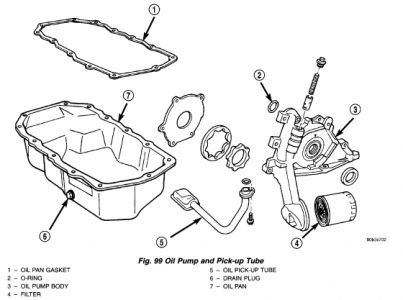

Fig. 99 Remove oil pump, and front crankshaft seal (Fig. 99). INSTALLATION Make sure all surfaces are clean and free of oil and dirt.

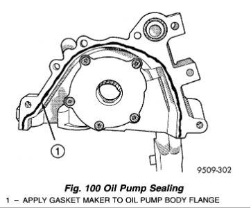

Fig. 100 Apply Mopar Gasket Maker to oil pump as shown in image. Install oil ring into oil pump body discharge passage (Fig. 100). Prime oil pump before installation. Align oil pump rotor flats with flats on crankshaft as you install the oil pump to the block. NOTE: Front crankshaft seal MUST be out of pump to align, or damage may result.

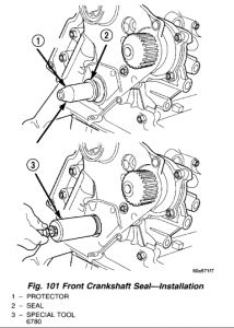

Fig. 101 Install new front crankshaft seal using Special Tool 6780 (Fig. 101).

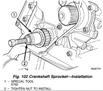

Fig. 102 Install crankshaft sprocket using Special Tool 6792 (Fig. 102). Install oil pump pick-up tube. Install oil pan. Install Timing Belt. https://www.2carpros.com/kpages/auto_repair_manuals_alldata.htm
