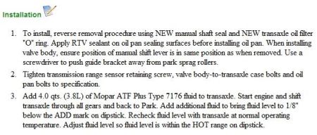

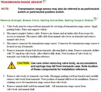

how do i change a neutral safety switch in a 2000 dodge stratus 2.5 v6 es with the autoshifter i have found the part on trans and now i need step by step info. i have had this car three years and its nothing but a pain but i wiil not sell it untill i know i have fixed it the right way i could not live with my self if i passed this problem on to a new owner so please send any info or pics my way thank you from CHRIS

https://images.2carpros.com/forum/automotive_pictures/261618_Noname_2123.jpg
https://images.2carpros.com/forum/automotive_pictures/261618_Noname2_686.jpg
