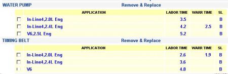

2000 Dodge Stratus 25000 miles
Cost of a Waterpump replacement installed
Saturday, January 10th, 2009 AT 12:28 PM
ZACKMAN
MECHANIC
4,202 POSTS
Make sure that you replace the timing belt at the same time. The timing belt is already off to get to the water pump.
Parts prices really varies by localities, so may want to do the separate research.
