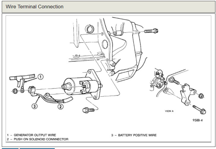

1999 Dodge Stratus 4 cyl Front Wheel Drive Automatic
How do you remove the bottom bolt of the starter? what do I have to remove to get to it?

This guide will help walk you through the repair with diagrams below for your car. https://www.2carpros.com/articles/how-to-replace-a-starter-motor
https://images.2carpros.com/forum/automotive_pictures/170934_1999_1.jpg
https://images.2carpros.com/forum/automotive_pictures/170934_19991_1.jpg

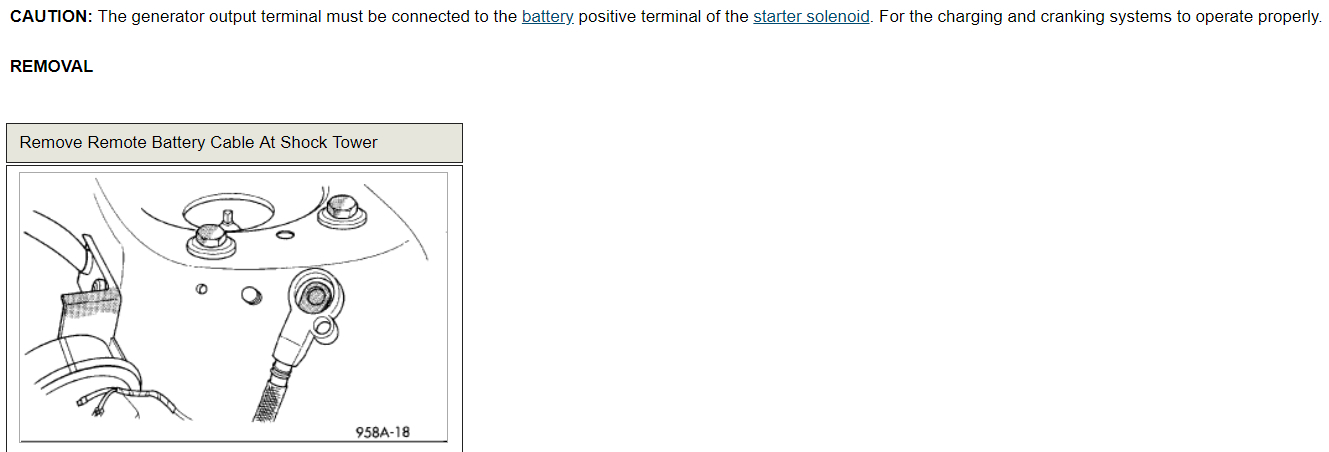

Remove negative battery cable from the left strut tower. Remove your air intake box. You may need to remove the transmission control module as well, but do not disconnect the wiring harness. Once those are out of the way, you will see the top mounting bolt. Remove it.
Raise vehicle. From under the vehicle, locate at remove electrical connectors from the starter. Then remove the bottom mounting bolt. Starter is removed from under the vehicle.

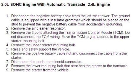

BLUELIGHTNIN6
  • 16,542 POSTS
Disconnect the negative battery cable from the left strut tower. The ground cable is equipped with a insulator grommet which should be placed on the stud to prevent the negative battery cable from accidentally grounding.
Remove the air cleaner resonator.
Remove the 3 bolts attaching the Transmission Control Module (TCM). Do not disconnect the TCM wiring. Move the TCM to gain access to the upper starter mounting bolt.
Remove the upper starter mounting bolt.
Raise and safely support the vehicle.
Remove the positive battery cable nut and disconnect the cable from the starter.
Disconnect the push-on solenoid connector.
Remove the lower mounting bolt that attaches the starter to the transaxle.
Remove the starter from the vehicle.

1. Detach negative battery cable from the ground stud on the left shock tower.
2. Remove air cleaner assembly.
3. Remove Transmission Control Module and move it out of the way. DO NOT remove the TCM connector.
4. You should be able to see the starter and the top mounting bolt. Remove it.
5. Raise the vehicle.
6. Remove wires from starter terminals.
7. Support the starter motor, and loosen and remove the bottom mounting bolt.
8. Withdraw starter from engine.

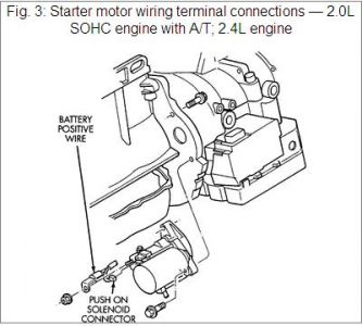

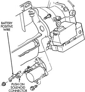

BLUELIGHTNIN6
  • 16,542 POSTS
REMOVAL: Disconnect the negative battery cable from the left strut tower. The ground cable is equipped with a insulator grommet which should be placed on the stud to prevent the negative battery cable from accidentally grounding. Remove the air cleaner resonator. Remove the 3 bolts attaching the Transmission Control Module (TCM). Do not disconnect the TCM wiring. Move the TCM to gain access to the upper starter mounting bolt. Remove the upper starter mounting bolt. Raise and safely support the vehicle. Remove the positive battery cable nut and disconnect the cable from the starter. Disconnect the push-on solenoid connector. Remove the lower mounting bolt that attaches the starter to the transaxle. Remove the starter from the vehicle. ((Starter motor wiring terminal connections- 2.4L engine))
https://images.2carpros.com/forum/automotive_pictures/261618_0900c15280089646_1.jpg
INSTALLATION: Install the starter onto the transaxle and the lower mounting bolt. Tighten the mounting bolts to 40 ft. lbs. (54 Nm). Before reconnecting the wiring to the starter solenoid, be sure to clean the wiring of any dirt or corrosion. Reconnect the positive battery cable to the solenoid post and tighten the retaining nut to 90 inch lbs. (10 Nm). Reconnect the push-on solenoid connector. Lower the vehicle. Reinstall the upper attaching bolt and torque to 40 ft. lbs. (54 Nm). Reinstall the TCM to its original location and install the mounting screws. Reinstall the air cleaner resonator. Reconnect the negative battery cable. Thanks for using 2CarPros.com!
