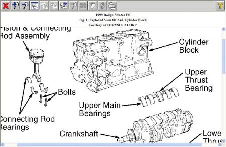

  • 75,992 POSTS
Looking at the picture below its gonna be at the firewall side towards the front of the engine block near the timing belt
https://images.2carpros.com/forum/automotive_pictures/12900_block1_1.jpg

CSCRAB
  • 12 POSTS
I replaced the oil pressure sensor switch today. It was located where you indicated. Just about in the middle of the block on the firewall side, had to access it from underneath the car. Old one was leaking out of the plastic end. Mine had the green colored connector. The hardest part was getting that off. I went and purchased the new sensor and also had to purchase a oil sensor socket to remove and install no other way to get it out. I installed the new one as close as I could to match how many threads were showing on the old one. I did not know how far to screw it in, but I did position it in the same place as the old one once I felt it getting snug. I cleaned the green connector and attached it to the new sensor with the small red clip you have to remove to get the connector off. After doing a test drive the oil light does not come on at idle.
This fixed the problem. I just hope I have it screwed in far enough. Thanks so much 2carpros for your immediate help and doing the very best to answer all my questions. Many thanks!
