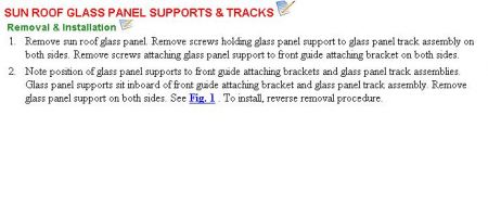

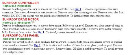

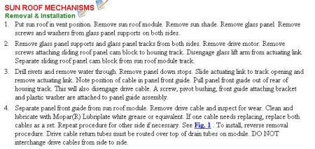

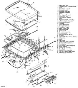

i cant close the sunroof. you can hear a click. but nothing happens. i dont have the owners manual handy could it be a fuse maybe??
Feb 8, 2009 at 5:58 AM
ZACKMAN
  • 4,202 POSTS
Not fuse. Your sunroof is either off the track, broken cable, or worn motor.
