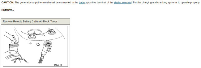

starter replacement and location?
RADIO95
Electrical problem
1999 Dodge Stratus 4 cyl Front Wheel Drive Automatic
How do you remove the bottom bolt of the starter? what do I have to remove to get to it?

This guide will help walk you through the repair with diagrams below for your car. https://www.2carpros.com/articles/how-to-replace-a-starter-motor

  • 4,202 POSTS
Remove the battery cables from the fuse box and strut tower. Remove 2 starter connectors and 2 mounting screws.

  • 4,202 POSTS
Remove negative battery cable from the left strut tower. Remove your air intake box. You may need to remove the transmission control module as well, but do not disconnect the wiring harness. Once those are out of the way, you will see the top mounting bolt. Remove it.
Raise vehicle. From under the vehicle, locate at remove electrical connectors from the starter. Then remove the bottom mounting bolt. Starter is removed from under the vehicle.

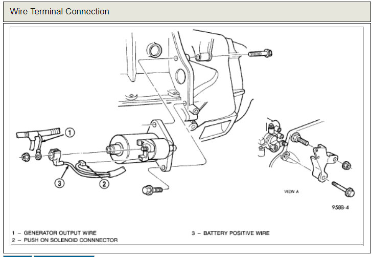

REMOVAL: Disconnect the negative battery cable from the left strut tower. The ground cable is equipped with a insulator grommet which should be placed on the stud to prevent the negative battery cable from accidentally grounding. Remove the air cleaner resonator. Remove the 3 bolts attaching the Transmission Control Module (TCM). Do not disconnect the TCM wiring. Move the TCM to gain access to the upper starter mounting bolt. Remove the upper starter mounting bolt. Raise and safely support the vehicle. Remove the positive battery cable nut and disconnect the cable from the starter. Disconnect the push-on solenoid connector. Remove the lower mounting bolt that attaches the starter to the transaxle. Remove the starter from the vehicle. ((Starter motor wiring terminal connections- 2.4L engine))

SCOTT5MICHELLE
Engine Mechanical problem
1996 Dodge Stratus 4 cyl Two Wheel Drive Automatic
how do I change the starter in a 1996 dodge stratus? Is it easy to get to?

ZACKMAN
  • 4,202 POSTS
It is fairly simple. As always, remove the cables from the battery.
1. Remove your air filter box and assembly.
2. Remove mounting bolts to your TCM (transmission control module), but do not remove the wiring harness. Move the unit out of the way.
3. Remove two top mounting bolts.
4. Jack the front of the car.
5. Remove wiring harness and connector from the starter solenoid.
6. Support the starter unit, and remove lower mounting bolt. Remove starter away from vehicle (bottom).
Installation is reversed.
