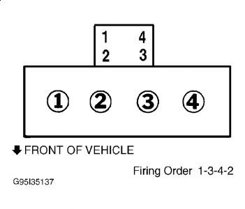

I had to remove the spark plugs to replace the valve cover gasket. I foolishly mixed up the wires and i was wondering if anyone had the wiring alignment for the spark plugs. i can't seem to get them right and i was wondering if anyone knew the order.
