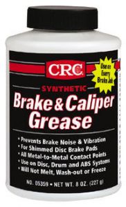

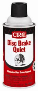

If the noise only happens when the brake is being applied, it has to come from the brake system. If the technician claims that your brake is fine and needs no attention, ask him then, why it squeals every time you apply the brake. I have seen, in other vehicles, by using inferior brake pads and/or not applying brake caliper grease such as
https://images.2carpros.com/forum/automotive_pictures/55316_05359_2.jpg
or noise-quiet material such as CRC 05017
https://images.2carpros.com/forum/automotive_pictures/55316_05017_1.jpg
will cause the squeaking noise that you are describing.

I wouldn't know what your local Midas uses. Usually most shop will find the most economical parts to minimize cost and maximize their bottom line. It is fairly easy to apply the brake grease. Raise the vehicle and remove the wheels. Do one side completely before attempting the other side. This way, if you happen to forget how a part is attached, you can look at the other side. It should the "mirror image" of the side that you are working on. Use 17mm socket and 3/8 ratchet and remove the top caliper bolt. Swing the caliper towards the rear of the vehicle (pivoting on the lower caliper bolt). Remove the brake pad (one at a time). Apply the brake grease at all metal-to-metal contact points
https://images.2carpros.com/forum/automotive_pictures/55316_pgd650m1_1.jpg
Re-install brake pads. Wipe clean the caliper bolt and apply brake grease all over the bolt (except the bolt head, of course. Install the caliper and tighten the caliper bolt. Now do the other side.
