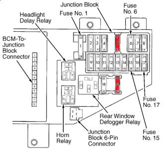

my sunroof wont open what should i do

https://images.2carpros.com/forum/automotive_pictures/55316_98startusfusebox_1.jpg
Start by checking fuse #5 and circuit breaker #19, inside your fuse block, at the end of dash, driver side.
