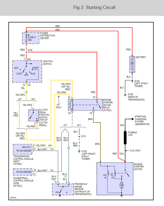

My 1998 Dodge Stratus would not crank. It would not say a word and the dash is only diplaying half of wht it should when key is turned. I checked th fuses first and found that a the fuel ignition fuse in the fuse box under the hood was blown so I replaced it..three times back to back and each time the fuse blew each time I tried to crank my car. Any idea what could be causing this problem?

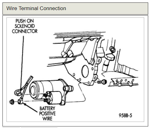

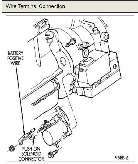

It sounds like you have a starter or the wiring down by the starter shorted to ground which is common. Here is a guide to help us get started and see what you are in for when doing the job.
You will need to jack your car up
Here is a starter wiring diagrams so you can see what's going on.
