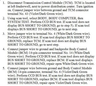

1998 Dodge Stratus Code 1698 no comm between tcm and bcm
1998 DODGE STRATUS
145,623 MILES • 6 CYL • FWD • AUTOMATIC
RDROUAULT
Transmission intermittently goes into limp-in mode and sets check engine light for code 1698 have checked wiring and verified communication loss on tcm.
have tried using a tcm of another stratus but has same problem
Would appreciate any help u can give

https://images.2carpros.com/forum/automotive_pictures/55316_98stratusp1698_1.jpg
If you are to switch the Body Control Computer, make sure that the other Stratus or Cirrus has the same engine and 1997 and up. See what happens.
