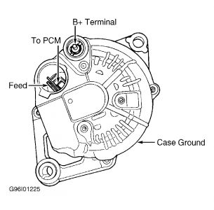

I had my alternator rebuilt 3 months ago and my car died again.
so i put a new battery in three weeks ago it ran fine then the power started failing again.
I was told it could be a connection between the battery and the alternator.
can you help me???

You have to charge battery start car and check the voltage on the battery it should be above 14 volts with car running if not check with key on engine off check for a battery volts at the back of alternator
https://images.2carpros.com/forum/automotive_pictures/99387_ater_1.jpg
