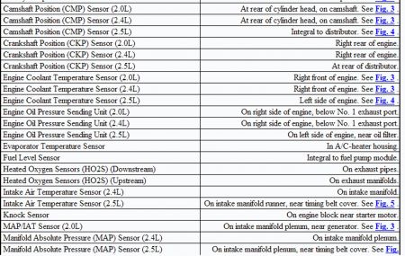

I have a 1997 Stratus, 4-cylinder, with about 85,000 miles. I can not find any mention of the oil sending unit in the Haynes manual. Where is it located?

You did'nt say what size 4 cyl..so heres the whole chart!
https://images.2carpros.com/forum/automotive_pictures/62217_Sender_1.jpg
