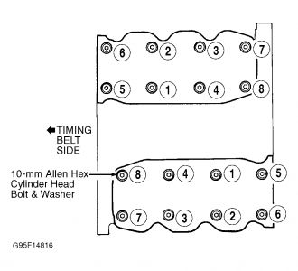

1997 Dodge Stratus headbolts on a 1997 dodge stratus
109,000 MILES • 6 CYL • FWD • AUTOMATIC
MADMIKE1735
  • 951 POSTS
just wondering what size allen i will need to remove these headbolts... im gonna buy a 1/2 drive allen socket, but not sure what size i need... thanks
Feb 22, 2009 at 9:52 AM
ZACKMAN
  • 4,202 POSTS
It is Metric 10mm Allen
