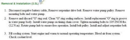

1996 Dodge Stratus 6 cyl
How to replace waterpump, drivebelts.
