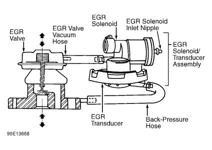

1996 Dodge Stratus 4 cyl Four Wheel Drive Automatic 120k miles
Hello, after 10-15 min driving, the car tursn or changes automatically running only on 1st, not changing to 2nd, 3rd or 4th.
It only happends after driving over 10-15 min. You may wonder if the car heats up, no does not, it has gas, oil and everything.
A mechanic told me it had something to do with the sensors; AutoZone told me to see the manufacturer vendor since this was a transmission issue.
Just need to know what is your expert opinion.
Is it a transmission problem or has something to do with sensors?
Please reply to me if you have any questions, I will answer quickly.
Thanks!

do you have a check engine light on
have it scanned for code s
let me know the code
you need to scan(TCM) the tranny computer for the codes
most common is tranny solenoid

P0401 inspect EGR vacuum lines inspect EGR valve gasket inspect exhaust system for leak and repair check EGR valve remove and clean if needed if sticking replace check EGR solenoid and electric connection inspect manifold and tube for restriction check all hoses
https://images.2carpros.com/forum/automotive_pictures/99387_egr_95_1.jpg
