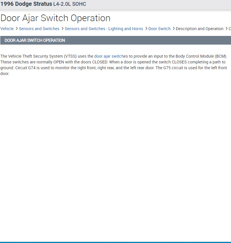

for some reason when we drive the door symbol comes up and beeps?
1996 DODGE STRATUS
KEVIN2123
yes i fixed the car door that way we can open it but for some reason when we drive the door symbol comes up and beeps at us but it does not do it all the time what could be the problem
Oct 29, 2008 at 8:59 PM
SQM
  • 6,383 POSTS

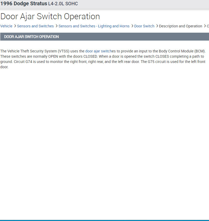

It sounds like the door ajar switch probably has loose connection.
The Vehicle Theft Security System (VTSS) uses the door ajar switches to provide an input to the Body Control Module (BCM). These switches are normally open with the doors closed. When a door is opened the switch closes completing a path to ground. When the switch goes bad it can produce faulty signal.
Check to see if the switch is aligned properly and the connection is secured. Look for any damaged wires for the switch.
