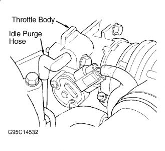

Thanks so much for the information you have given me. I have just have one more question; "what is the throttle body,' "and where is it located?

this is on a V6 where air enter the engine
https://images.2carpros.com/forum/automotive_pictures/99387_Graphic1_675.jpg
