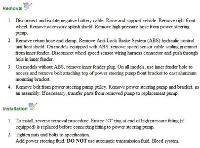

How do u Change the power steering pump if the back of the sub frame doesn't drop??;;

https://images.2carpros.com/forum/automotive_pictures/261618_Noname_2378.jpg
