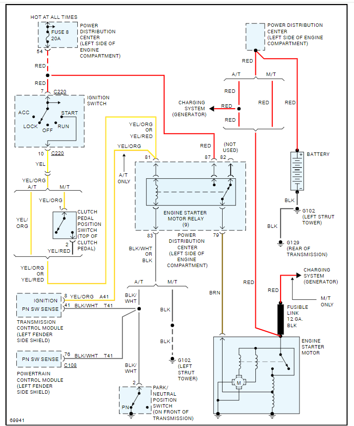

HODGEY
the car will not turn over, the lights work the clock the odometer works the digital tranny selector works, but the clock does not work or the radio. the engine does even make a sound when you turn the key.

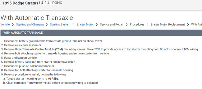

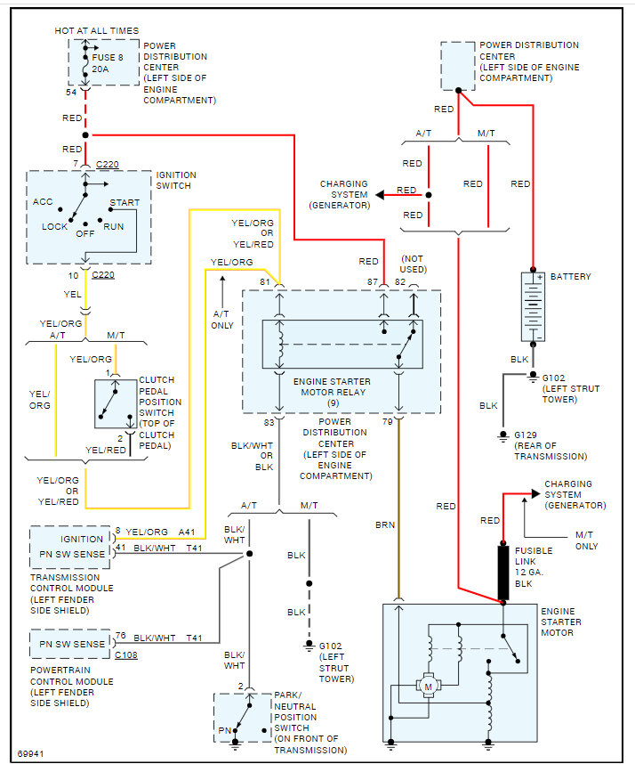

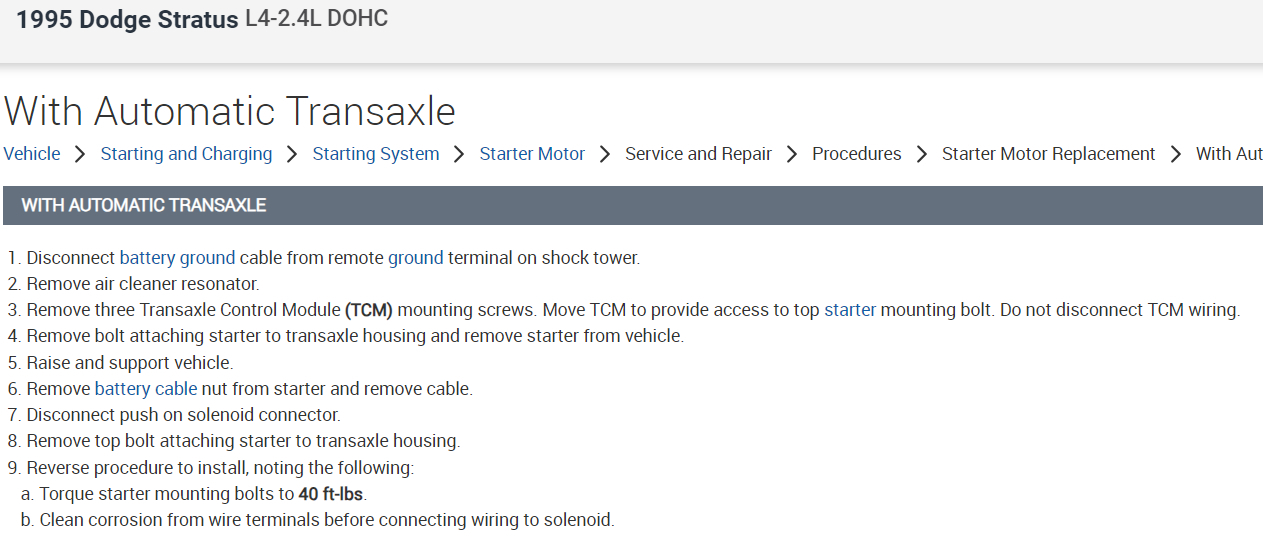

I have seen the start motor go out on these cars, here is a guide to make sure. Use a test light to see if there is power at the starter terminal.
Here is the location of the starter so you can check it out and replace the unit is needed. Also you should check fuse # 8 in the fuse panel under the hood. I have included the starter wiring diagrams as well so you can see how the system works. Check out the images (below). Please let us know what happens.
