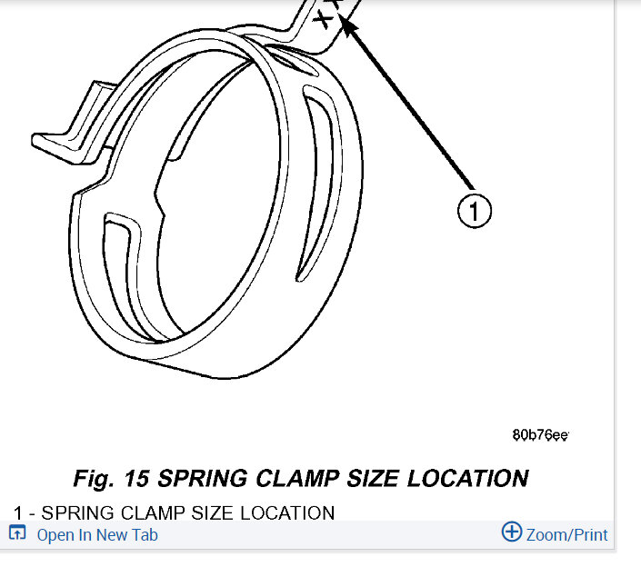

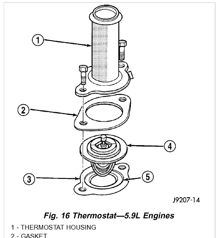

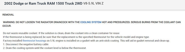

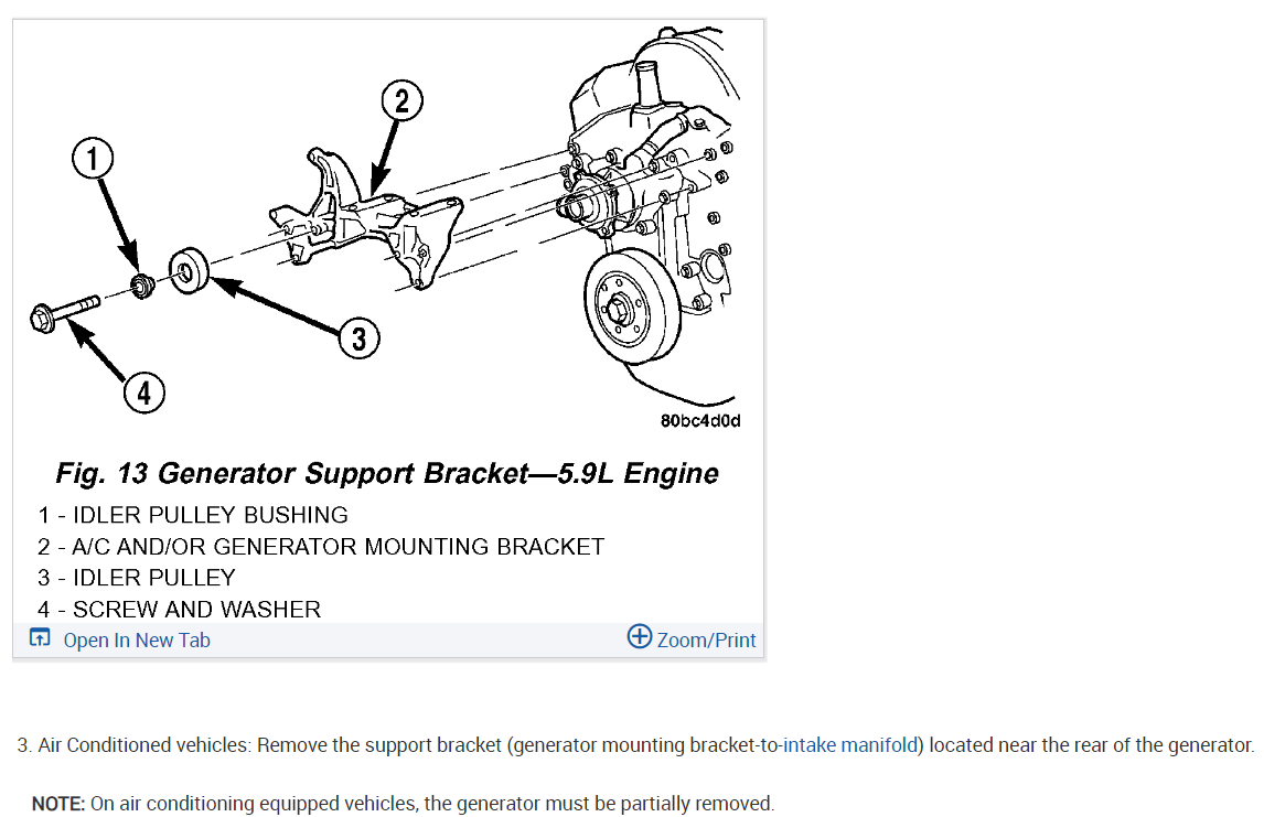

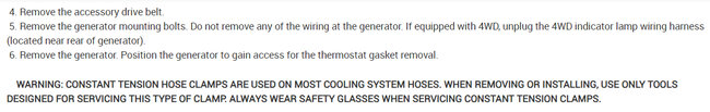

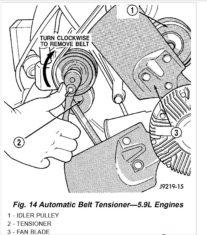

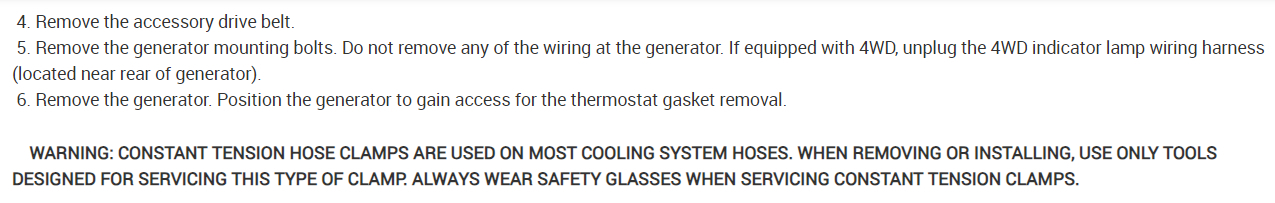

My heater is only blowing warm air, where is the modulator located that opens closes that "flap" to allow it let open and close all the way? I don't know what the part is called...sorry
Dec 4, 2007 at 5:55 AM
PEAR69
  • 1,482 POSTS

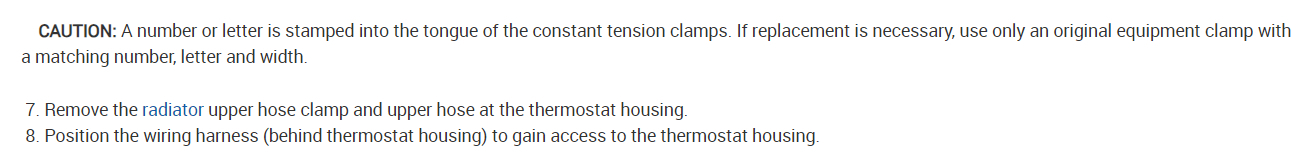

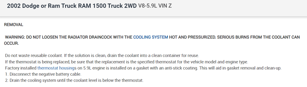

It sounds like your thermostat is stuck open.
Dec 4, 2007 at 8:38 AM
  • 55,399 POSTS
Yep I agree here is a guide to help us fix it and I have included how to change thermostat out as well in the images below.
