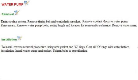

do u know where i can get a free diagram so i can replace the water pump in my 93 dodge stealth

let me know if you need further assistance with this repair..
https://images.2carpros.com/forum/automotive_pictures/261618_Noname_748.jpg
