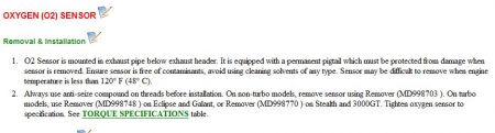

I had a full tune-up, plugs, wires, air filter, oil, etc performed Apr. 2008. About 3 weeks later, RPMS would fluctuate, car would "buck" and stall. Exhaust checked. No leaks. All scheduled maintenance has been performed on this "NA" vehicle. My import mechanic with 35 years experience no longer contacts me. NO, he would not have done anything to harm it. Bottom line...Where are the o2 sensors located? How do I access them? Bought (2) Bosch sensors and was told @ $300 for shop to install. Another mechanic friend is willing to install them; but first I would like to know where they are located. a pic would be helpful. I cannot afford $300 repairs, as a single mom with no income (pending disability). All plug wires are in proper order. Have had plugs changed and wires replaced at the same time twice.

our computers dont show pictures but the o2 replacement is not difficult and is pretty straight forward. they are located right at the exhaust manifold. i will look to see if i can get any sort of illustration for you but it will take a few minutes so hang tight.

picture may be hard to read but it just says its located in exhaust pipe under header. sorry no pictures
