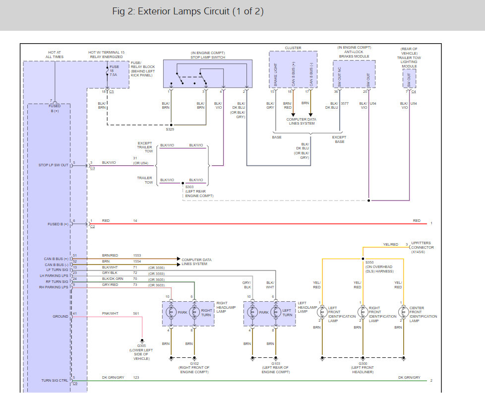

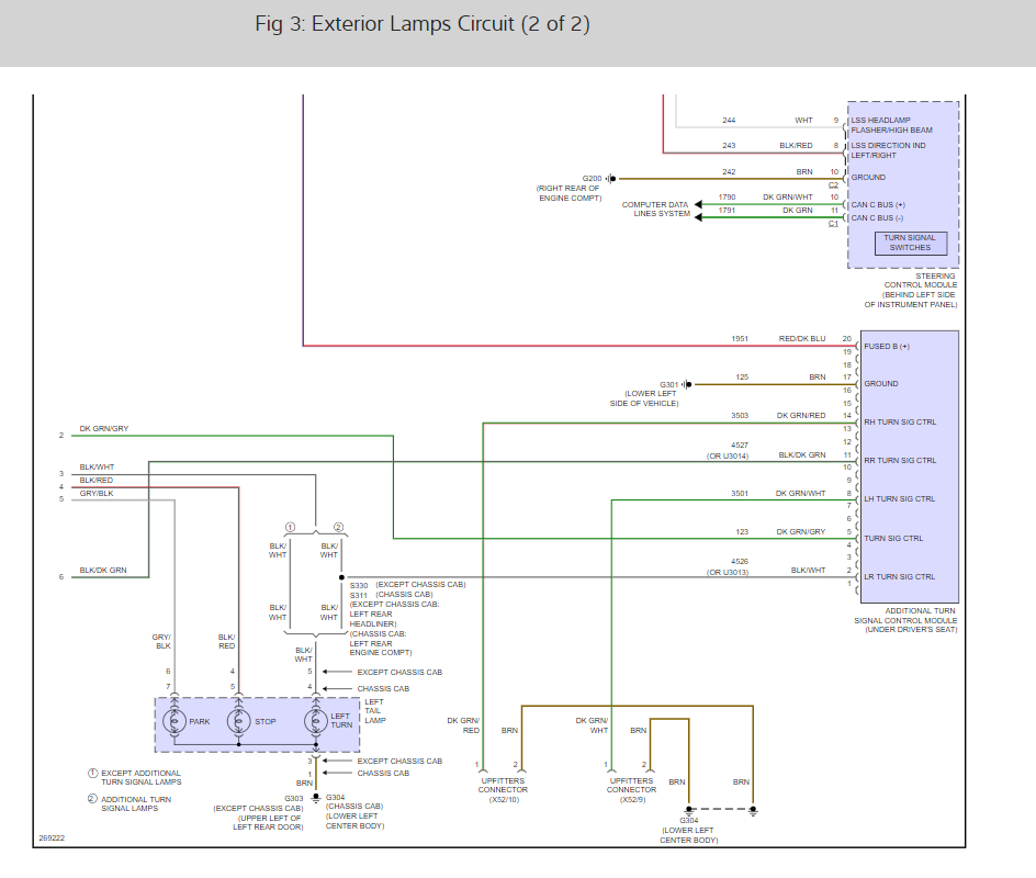

both lights on, won't blink on either side. hazard stay on without flashing. if module is the problem, where is it located. thanks, john

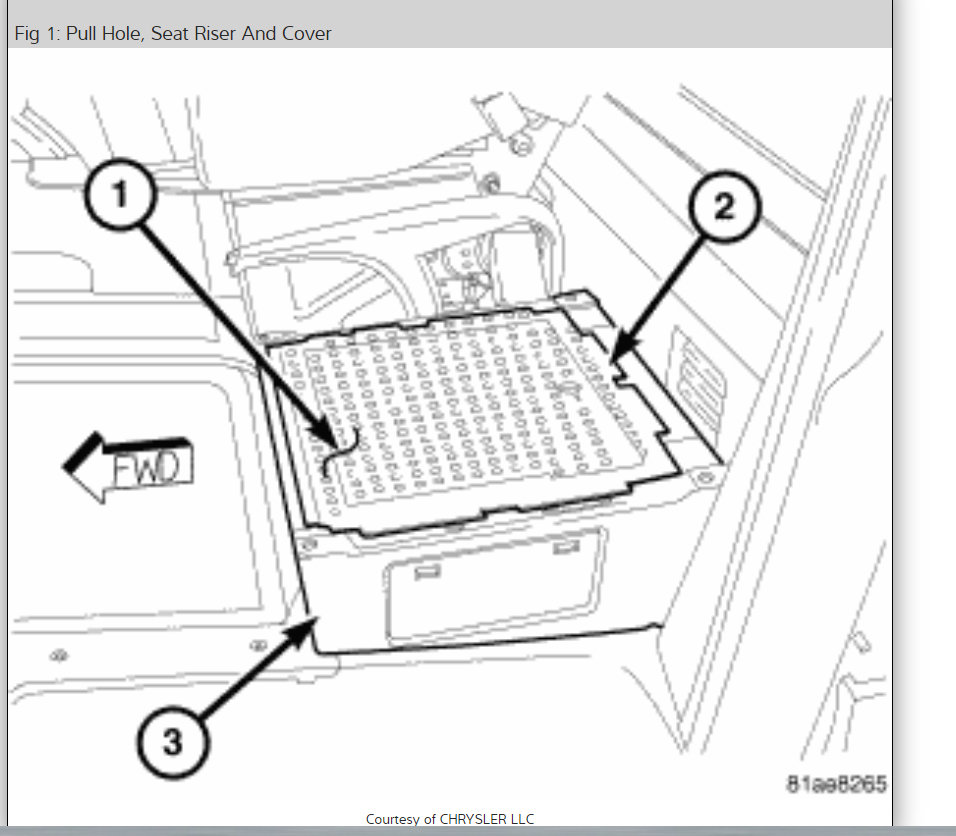

Check the turn signal control module under driver's seat

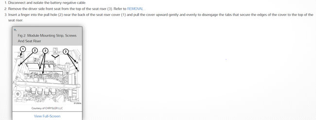

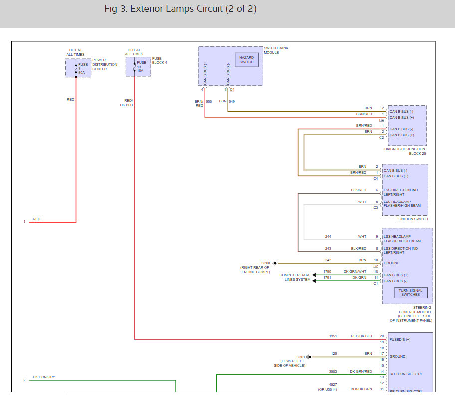

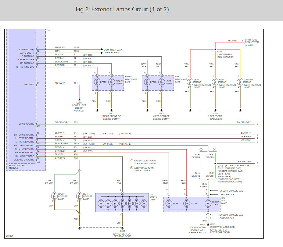

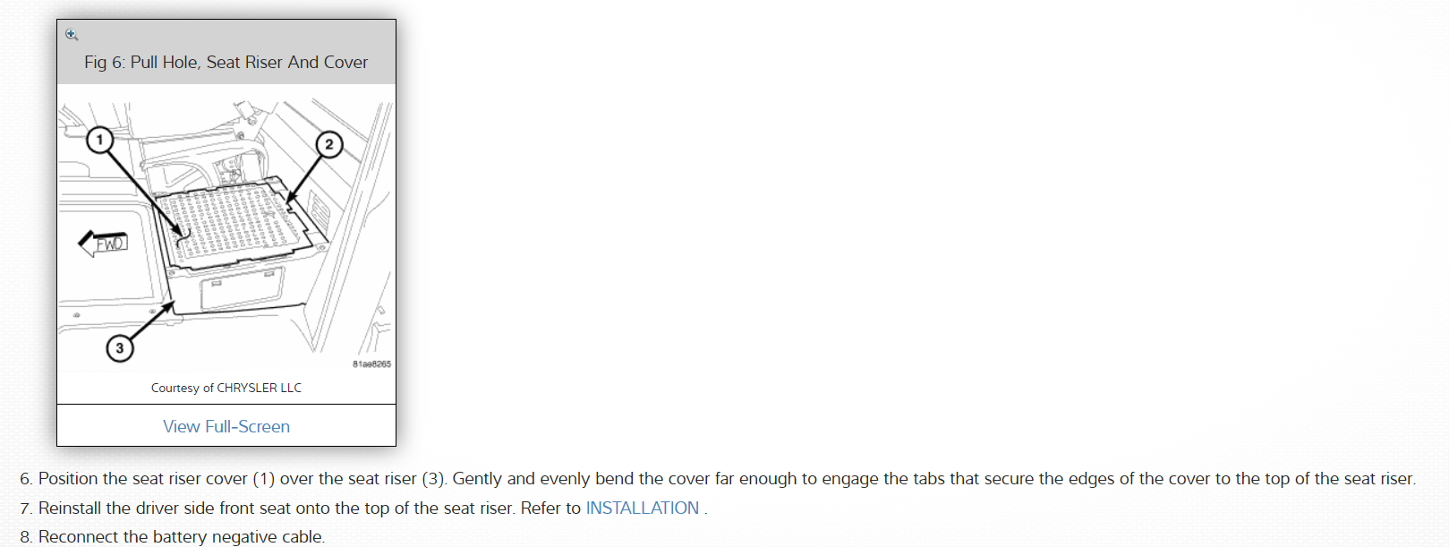

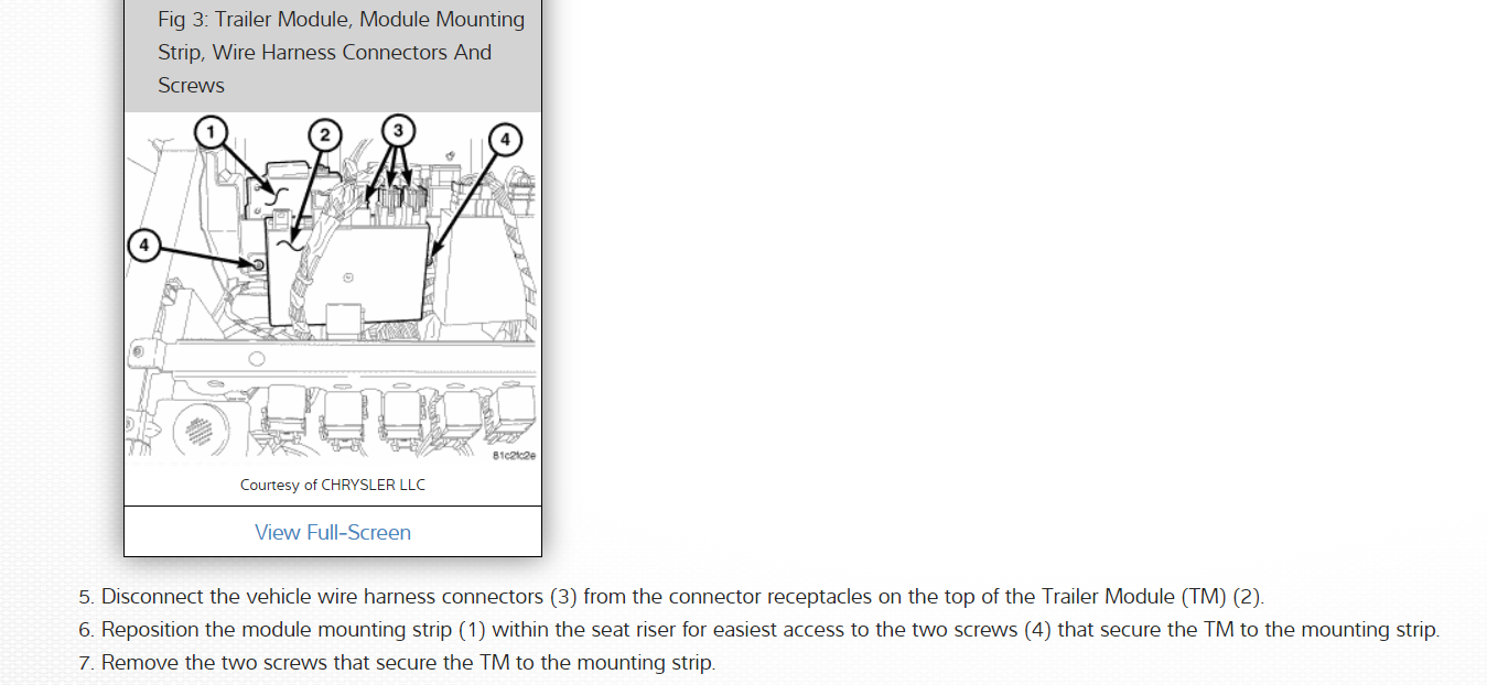

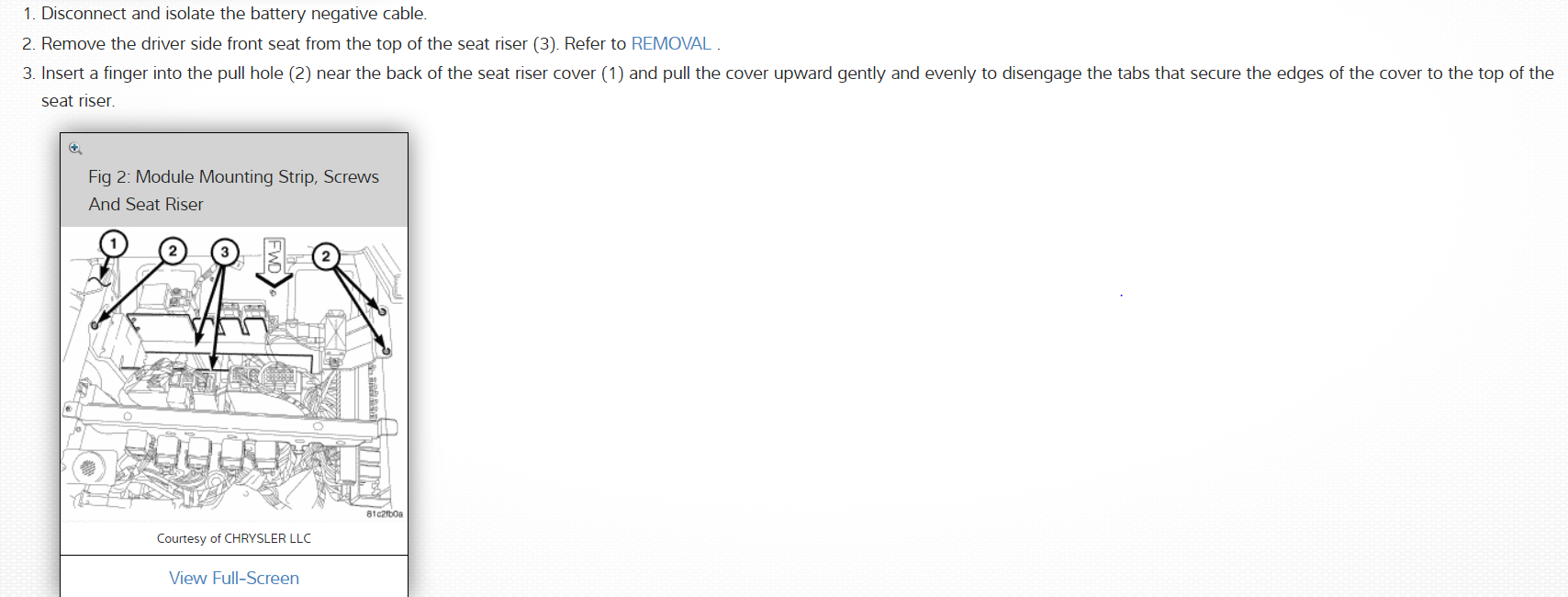

Here is the blinker wiring diagrams so you can see how the system works and the instructions so you can replace the brake control module.
