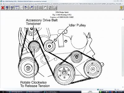

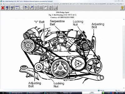

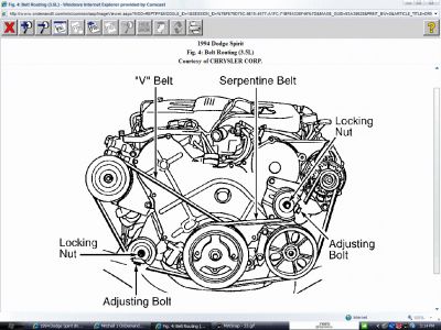

1994 Dodge Spirit V6 Front Wheel Drive Automatic 226000 miles
Can you show me a diagram of the positioning of the drive belt for my car?
Dec 8, 2007 at 2:08 PM
MERLIN2021
  • 17,250 POSTS
There are 3 V6 engines used in this model, 3.0, 3.3, and 3.5 I posted them in that order...
