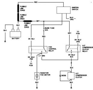

When I purchased the 93 dodge the air conditioning belt was missing. I checked that the AC clutch pulled in and it did not. I checked the fuse for voltage and it is good. I checked for voltage at the clutch and there was none. I do not have a manual or wiring diagram. What would be your suggestion to solve this problem
Apr 27, 2009 at 2:40 PM
JDL
  • 16,098 POSTS
https://images.2carpros.com/forum/automotive_pictures/170934_compressor_clutch_1.jpg
Hello, I came across the above wiring info, check for voltage at the ac compressor clutch relay.

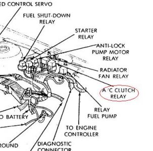

https://images.2carpros.com/forum/automotive_pictures/170934_ac_clutch_relay_1.jpg
ac clutch relay, under hood, driver side fender-well. I'm not an ac person, I didn't see a low pressure cutoff switch. On some systems the compressor won't run with low refrigerant. Not sure about your system? You can check if the clutch will engage.
