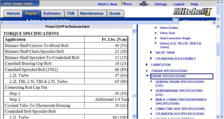

i need the torque specs for the rod cap bolts please

Here it is Sir
https://images.2carpros.com/forum/automotive_pictures/12900_rod_bearings_1.jpg
