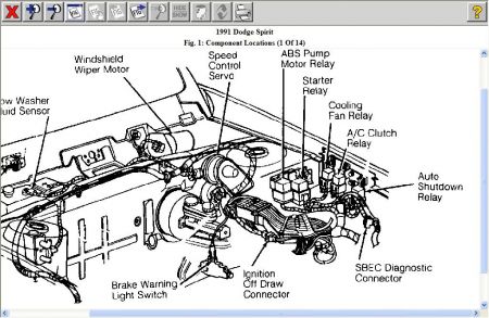

1991 Dodge Spirit 4 cyl Front Wheel Drive Automatic
i changed the fuel pump because the old one didnt run. i know the new one works {bench tested} but i dont seem to be getting any power at the plug. where is the relay or fuseable link?
Apr 3, 2008 at 1:19 PM
  • 75,992 POSTS
Test the auto shutdown relay ( ASD) it powers the fuel pump thru the dark green and black wire to the fuel pump-
