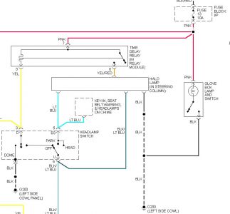

the light around the igition stays on
Apr 9, 2008 at 2:58 PM

And that light would be ?.....

[quote:b679c39a9b="Service Writer"]And that light would be ?.....[/quote:b679c39a9b]
the light where you put the key in

Ahh... I gotcha...the halo light. I would check the time delay relay...sounds like it isn't shutting down.
