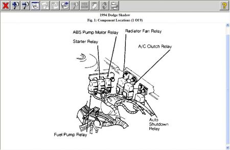

how to get it out. And where is the fuel relay switch

If there's no access door thru the back- you have to drop the tank and the fuel relay switch which is the fuel pump relay you're talking about is located in engine compartment front of left strut tower.
https://images.2carpros.com/forum/automotive_pictures/12900_fp_relay_2.jpg
