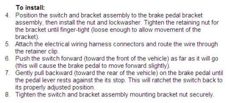

brake lights are staying on all the time there is nothing wrong with the brakes themselves believe it is in the switch how do I adjust it so that they don't

Welcome to the forum, does the highmount brake lite also stay on as well as the lower brake lites?
https://images.2carpros.com/forum/automotive_pictures/170934_shadow_brake_adjust_1.jpg
There is some adjustment info with the install procedure.
