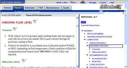

Ok so this is going to sound strange. I think I need to add transmittion fluid to my engine but I dont know where to add it can yo utell me ?
Jun 6, 2008 at 4:33 PM
  • 75,992 POSTS
The dipstick is somewhere within the transaxle could be red in color, look around its there. also see below
https://images.2carpros.com/forum/automotive_pictures/12900_tranny_fluid_1.jpg
