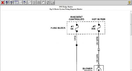

How do you troubleshoot heating ac system on 1993 Dodge Shadow that blower does not work and have checked blower motor it is good and have replaced relay resistor what else can it be and fuses.?

Check fuse no.1 4amp and fuse no.7 30amp

the no air comes out of the vents to warm or cool the inside of the car we have checked the heater/ac resistor and the blower and the fuses and they are all good....we don't know for sure how to tell if the heater/ac switch is bad or good and we don't know what else to check any help would be great....

Check the black wire on the switch to any ground-this is the ground circuit-if no continuity the ground wire is open

there were some wires melted together
