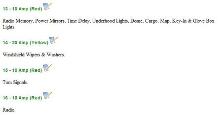

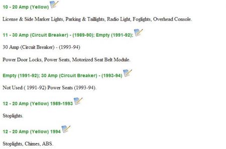

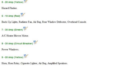

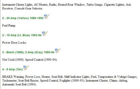

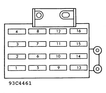

I lost the owners manual and need the positions of the fuses in the fuse box. (which fuse does what)
