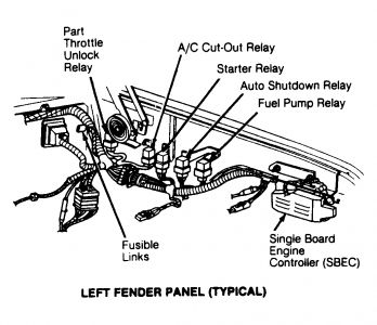

Fuse box under steering column worked loose and a wired grounded out. Truck died. Now turning key on makes lights work but starter isn't being engaged when I try to crank. No click, no sound at all. No fuses are blown. Starter Relay maybe? If so, where is the starter relay on this vehicle? I can't find it with the info provided in my Chilton manual.

Hello, This guide will help you check it with the location of the starter relay below. https://www.2carpros.com/articles/how-to-check-an-electrical-relay-and-wiring-control-circuit
https://images.2carpros.com/forum/automotive_pictures/198357_Graphic_649.jpg
