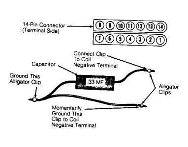

Vehicle did this two years ago, replaced pickup coil and that corrected the prob. So I replaced the p/u coil again, started it, ran it for 30 minutes. Turned off to button everything up, restarted and it ran for 30 seconds then cut off. Replaced Coil, start/run relay and ECC as this is has TBI was told it doesn't have an Ign module, or if it did it was in the ECC. After I replaced the ECC the truck started, I let it run for an hour, drove it down the road about 4 blocks, it shut off again and would restart, but only run for about 10 seconds. Thanks for any suggestions

Are you loosing spark? If you are, I need you to remove the 14 pin connector to the single module engine controler (SMEC) (with key off) and check all pins but specifically pin 12 and 14 to make sure they are not corroded and or bent. Chances are the smec is bad and causing this.
https://images.2carpros.com/forum/automotive_pictures/249084_aaaa_1.jpg
If it looks good, remove the coil positive terminal and connect a jumper from the battery to the positive on the coil. Momentarily ground pin 12 to produce spark. If spark is produced, replace the SMEC. If there is no spark, use a jumper to ground the coil neg. If no spark is produced, either you have a broken wire in the harness or the coil is bad. I have a feeling the SMEC is the cause of the problem. Let me know what you find.

Thanks! Will perform suggestions this am: The smec is built in to the ECC unit. Two lines plug into it, the one you want me to test and a much larger one. When you say you suspect a bad SMEC are you talking about the plug itself or the internal part of the new ECC I just replaced. Thanks again, I'll respond later.
