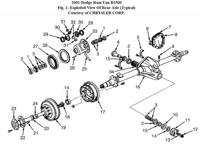

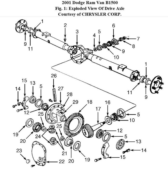

I had a lot of low grinding/winding in the rear of the truck. Thought it may be a pinion bearing so i began taking the differential apart. I cannot remove the gear assembly to get to the pinion bearing. I already removed the 2 cuffs on the side im not sure what they are called. I tried taking the pinion bolt out from in between the gears and stupidly moved the driveshaft and the small gears fell out. So i then took out the c clamps and pulled both axles. I have all but 1 of the driveshaft bolts removed also. So now i have no choice but to take out the gear assembly but i cannot figure out how. And i cant remember how i git the driveshaft to stop spinning to take out the previous 3 bolts. Im sure Ive bitten off more than i can chew. Please help me!
Sep 1, 2019 at 5:06 AM (Merged)
KHLOW2008
  • 41,814 POSTS
Here are the instructions on how to disassemble the differential on your truck. Check out the diagrams (Below). Please let us know if you need anything else to get the problem fixed.
