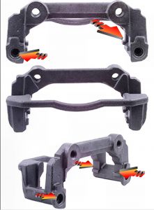

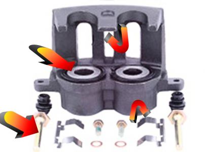

IF I am going to the point of pulling the rotors, I would do the pads. If I did not replace them then at the very least meticulously clean the points that the pads make contact with the bracket and caliper. The slide pins should be cleaned and lubed as well. Any tin clips should be wire wheeled on both sides and also lubricatd with high temp caliper grease.
Make sure the brake hose is not twisted when re-installing the caliper.
The problem with not servicing the caliper and hardware is that the pads will not move properly and will wear irregularly or create overheating of the rotor in some cases.

It's scary how many "professionals" don't do a proper brake job. In your case, the rotor problem is still going to be there. You need to narrow down which is the offending rotor...or rotors.
https://images.2carpros.com/forum/automotive_pictures/30961_caliper_lube_5.jpg
https://images.2carpros.com/forum/automotive_pictures/30961_caliper_lubeareas_5.jpg
https://images.2carpros.com/forum/automotive_pictures/30961_caliper_lubeareasbrack_5.jpg
This isn't the same as yours, but you get the idea.
