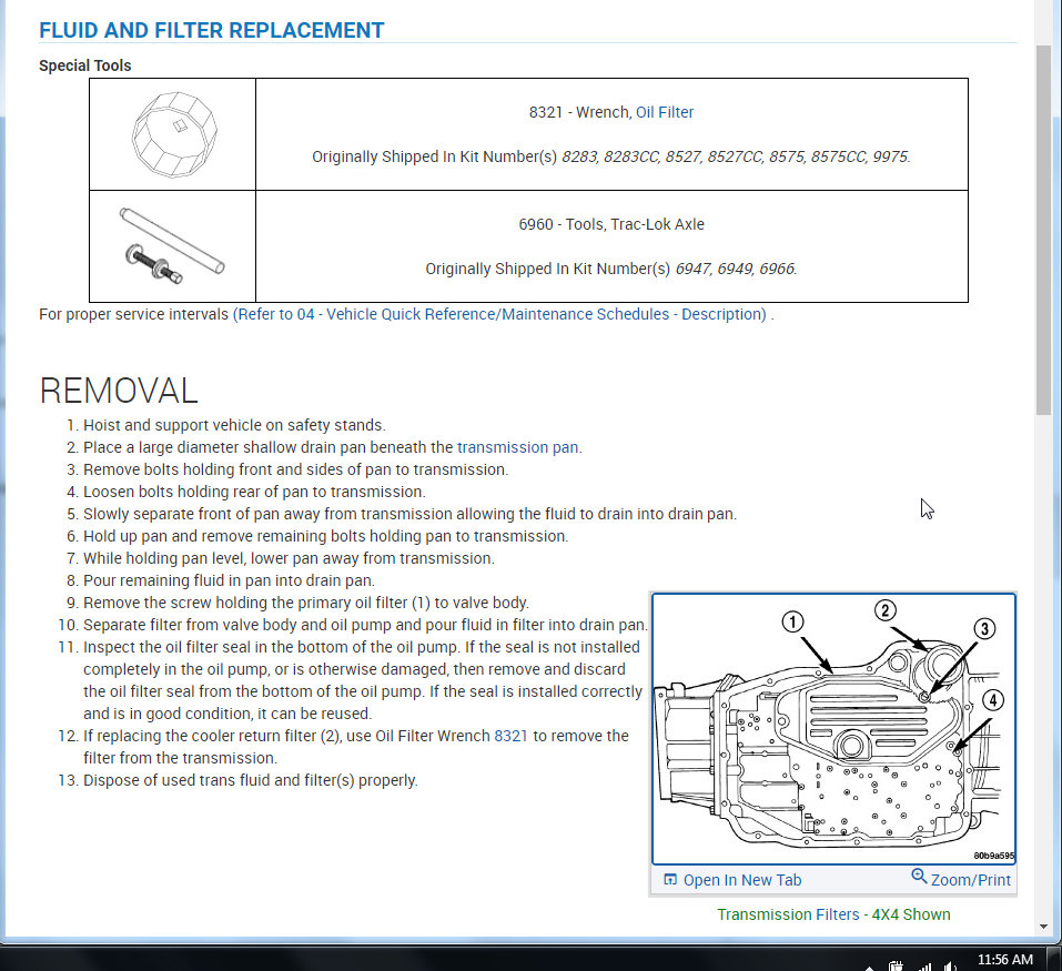

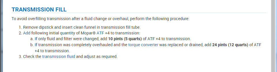

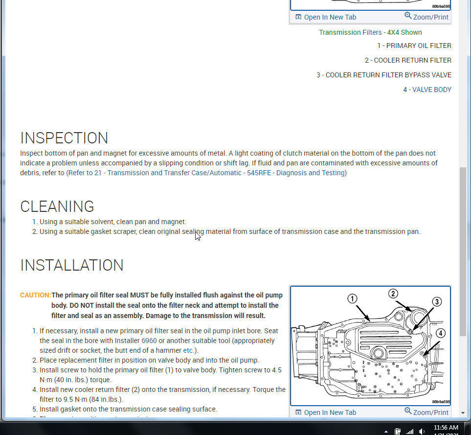

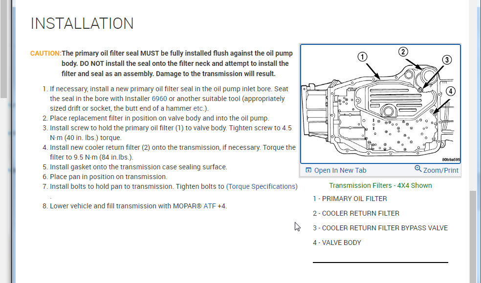

The problem i have is it wants to grind going between 2nd and 3rd gear. If I wait long enough between shifting it will go in smoothly. I can not down shift into 3rd from 4th at all. Thanks!!!!
Aug 1, 2007 at 6:48 PM
It does sound like a fluid or pump issue so we need to start with a service. Here is a guide that will help with this: This video shows the job being done on a similar car but the process is the same.
https://youtu.be/NUOBl4bqtss
and here is a guide to help you step by step with instructions in the diagrams below to show you how on your car.
Below is the process from the manual that will help with this as well. Please let us know if you have other questions. Thanks
