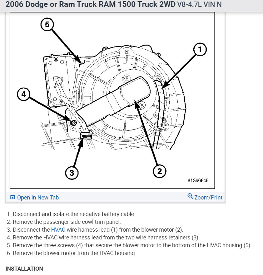

In shop several times in the past two years because of a defective re circulation door on the a/c. Even with this problem fixed the cab takes a very long time to cool down since the a/c fan blows weak. Even on the max fan setting, the motor seems to work fine but blows weak. Here in Phoenix with 110 + temperatures I find it uncomfortable to drive unless I'm on a trip and the truck's interior is allowed to cool for a couple of hours. Another thing that doesn't help is that the rear cab vent doesn't have the option to close, so I give up a/c to my rear cab (Mega Cab). This seems to be a problem with mid a/c systems, many have complained about this as I researched this topic online. My question is: Is there an high output motor that I can install to increase the flow? Thanks! HAZMAT9

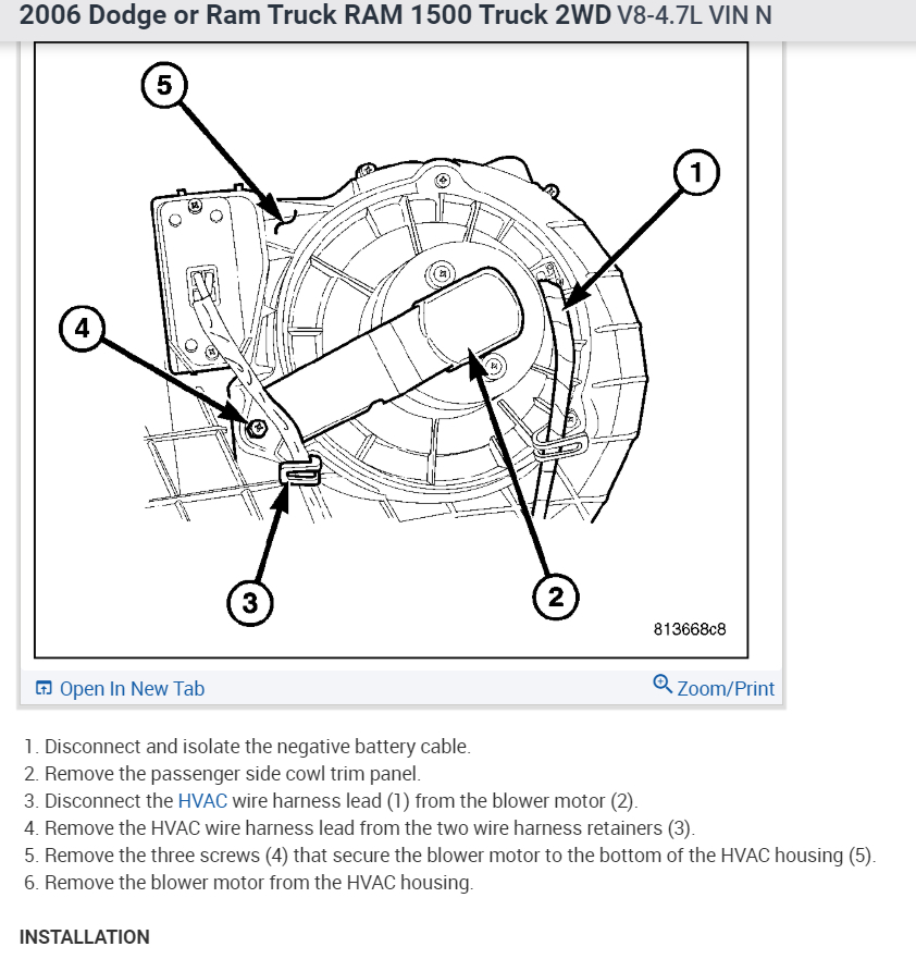

It sounds like the blower is weak even though you say is working correctly here is a guide to help test then power and ground of the system with diagrams below to show you how to change the blower out on your car.
https://www.2carpros.com/articles/blower-fan-motor-works-on-high-speed-only
Check out the diagrams (Below). Please let us know what you find. We are interested to see what it is.

Dodge Dealer checked out and replaced the blower working great again! thanks for your help.
