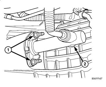

I replaced the clutch and flywheel in my '06 3500, 5.9TD Dodge.....but need to replace master/slave assembly, too.....had help with clutch, but none with this....is it a big deal, or "simple"...any schematics, video, or advice would be greatly appreciated!!
Dec 11, 2009 at 8:47 AM
DOCFIXIT
  • 18,828 POSTS
The ubit bleeds itself just pump the pedal about 25 times. Not to hard slave remove nuts shown as 1

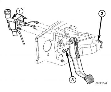

For master remove pin from pedal the unbolt and remove.
