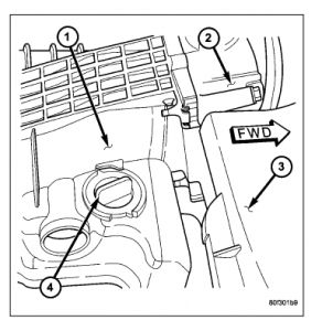

location of pcv valve? hemi magnum 5.7 liter
Mar 13, 2010 at 7:38 PM
  • 75,992 POSTS
https://images.2carpros.com/forum/automotive_pictures/12900_pcv_7.jpg
The PCV valve (4) is mounted into the top of the intake manifold (1). Please let us know if you need anything else to get the problem fixed.

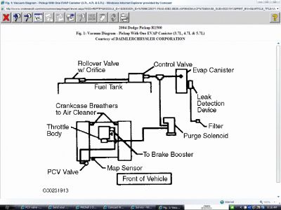

Dodge 2500, 2004 with 5.7L Hemi, 40,000miles
Where is the PCV valve located? My engine check light has come on and I am getting some blow back from the oil to the aircleaner with moisture in the oil fill cap area.

According to the diagram for systems with 1 or 2 cannisters, it's right at the front of the engine...
https://images.2carpros.com/forum/automotive_pictures/62217_PCV1_1.jpg

How would my engine run if the PCV valve was not correctly hook up , would it may a hissing sound?
Nov 9, 2019 at 5:07 AM (Merged)
HMAC300
  • 48,601 POSTS
if not hooked up correctly it could give you a large vacuum leak which is a hissing sound while running, especially at idle.
