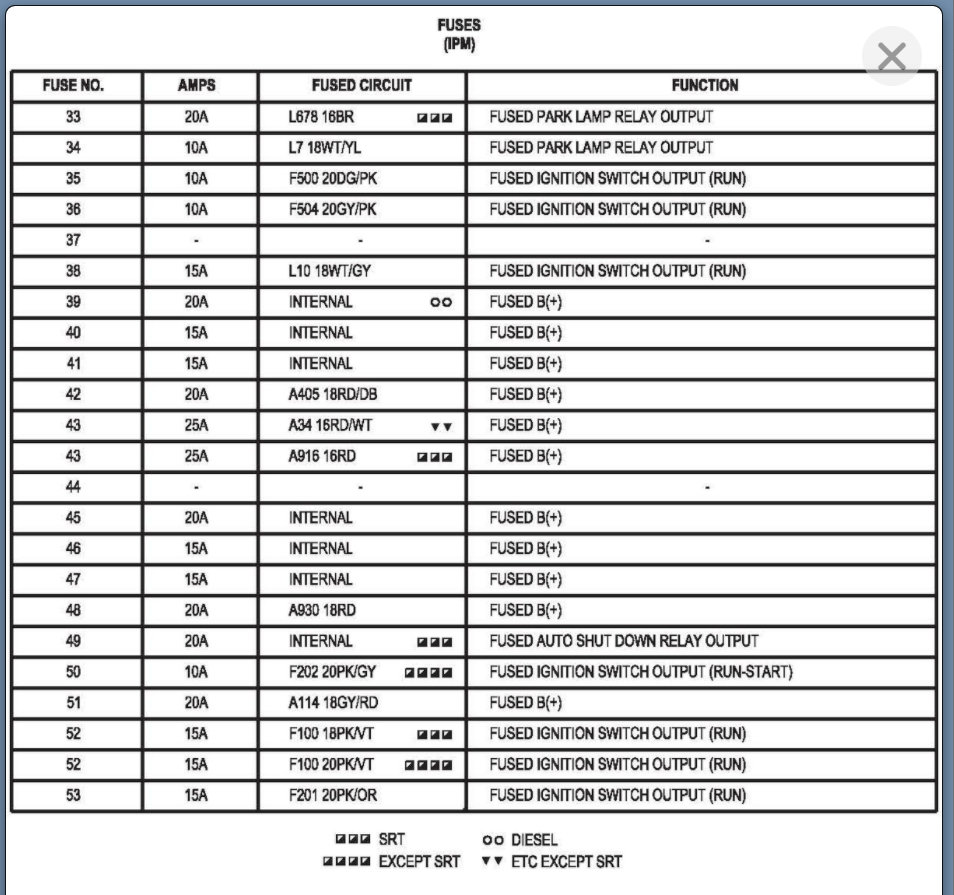

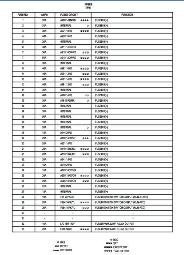

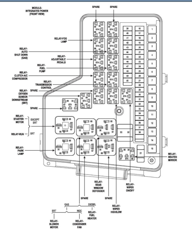

How do you find and check the fuses? I have a driver's door not working right
Sunday, March 21st, 2010 AT 2:15 PM
MECHANIC
18,907 POSTS
Here is a guide that will help with testing and replacing fuses if you need this:
Below is the diagram of the fuse block and the callouts that will help find what you are looking for. Please let us know if you have other questions after you review this.
