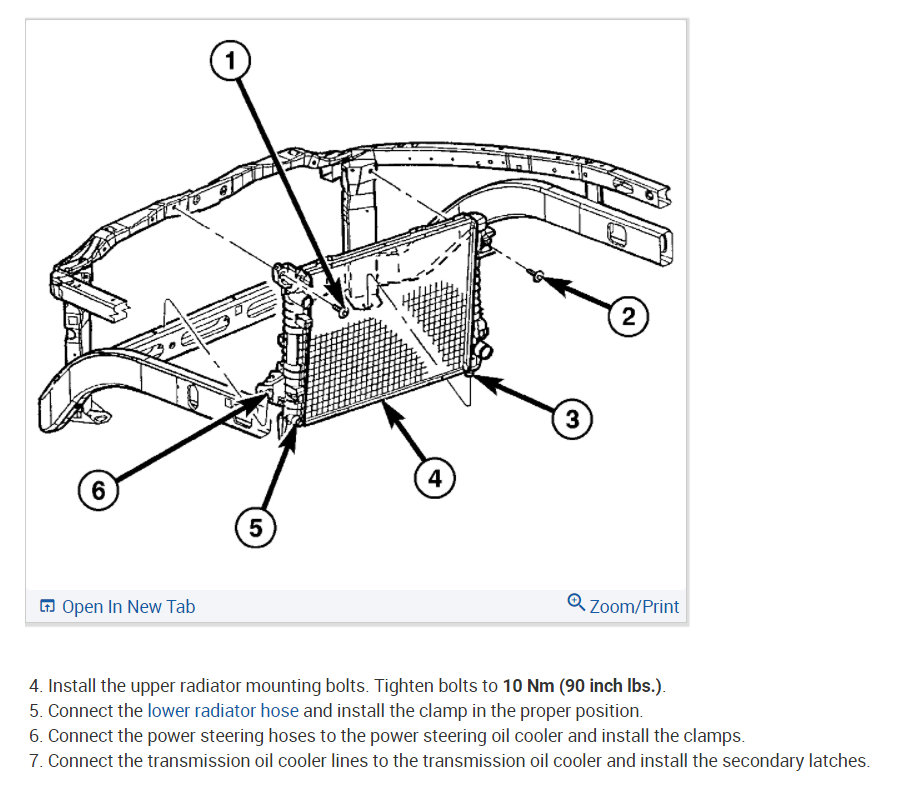

I have attempted to flush out the radiator several times, but was not successful. The drain plug tends to only turn a qtr turn. I was told to push an turn an pull an turn. Still only quarter turn! What am I doing wrong??
Dec 12, 2009 at 5:15 AM
NAVYRAY

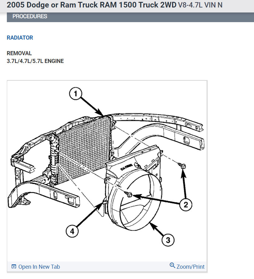

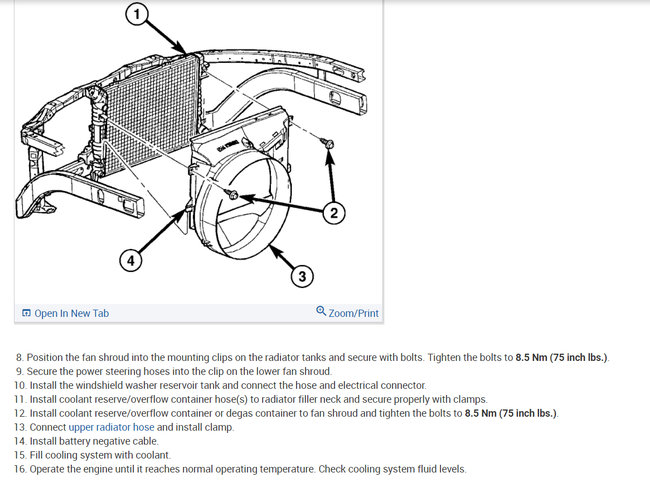

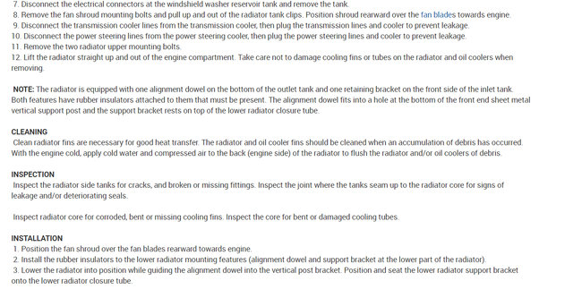

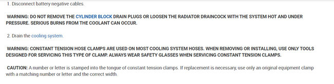

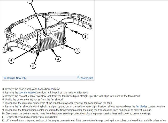

Here is a guide to help you step by step with instructions in the diagrams below to show you how on your car.
https://www.2carpros.com/articles/how-to-replace-a-car-radiator
Check out the diagrams (Below). Let us know what happens and please upload pictures or videos of the problem.
