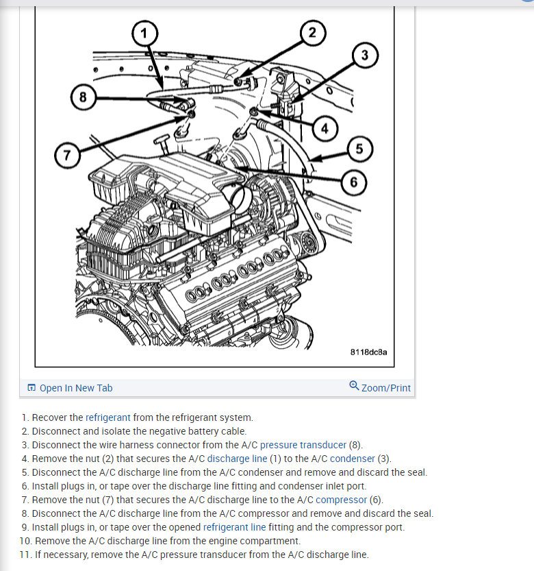

Need to know where the vehicle A/C low pressure port is located in the engine compartment.
Sep 14, 2009 at 2:25 PM
  • 55,402 POSTS

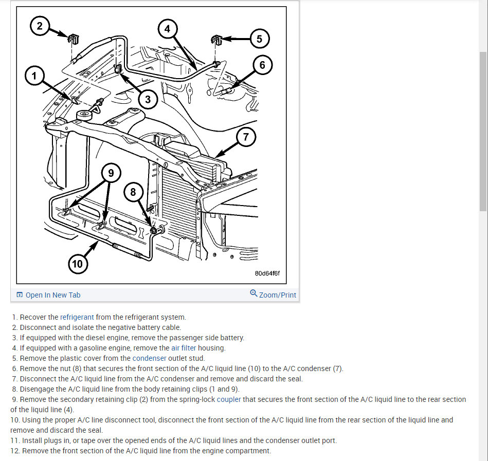

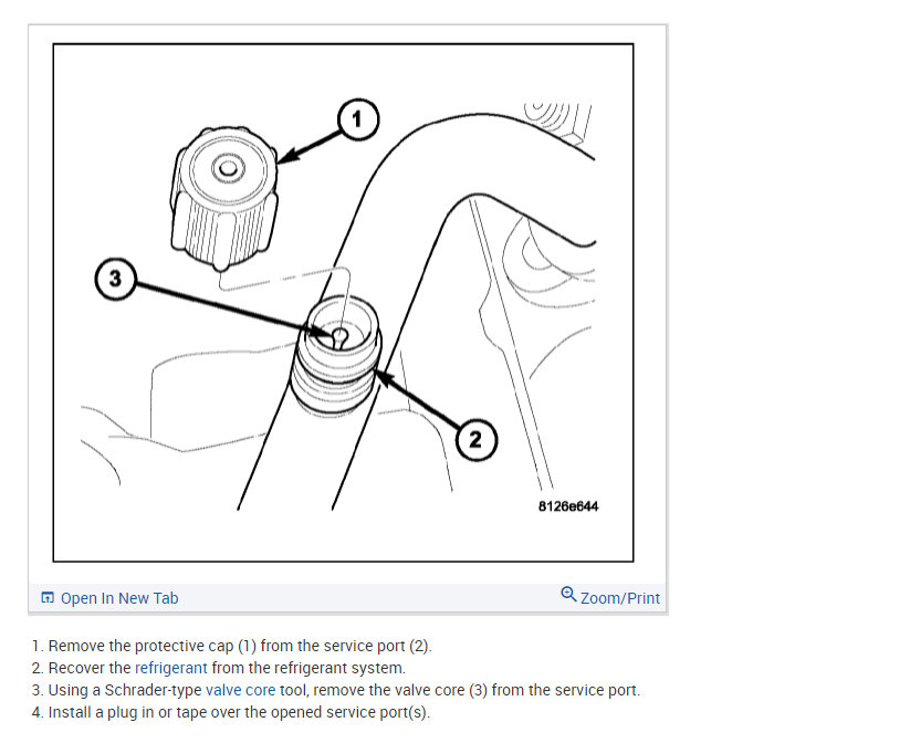

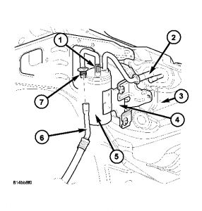

The low side service port the for air conditioner is located on the large tube /hose coming from the fire wall to the rear of the compressor. Here is a some guides that will help you get the job done and to see how the system works and what goes wrong with it. Here are videos and guides to show you how to recharge your air condition system and find the charge port. https://youtu.be/uZrQCGwXfek and https://www.2carpros.com/articles/air-conditioner-how-to-add-freon and https://youtu.be/ON2dYcmXIAw and https://www.2carpros.com/articles/how-a-car-air-conditioner-works and https://www.2carpros.com/articles/car-air-conditioner-not-working-or-is-weak Here are some diagram I found that will show you where the service ports are as well. (below) #7 should be low side
https://images.2carpros.com/forum/automotive_pictures/261618_Graphic_174.jpg
Check out the diagrams (Below). Let us know what happens and please upload pictures or videos of the problem.
