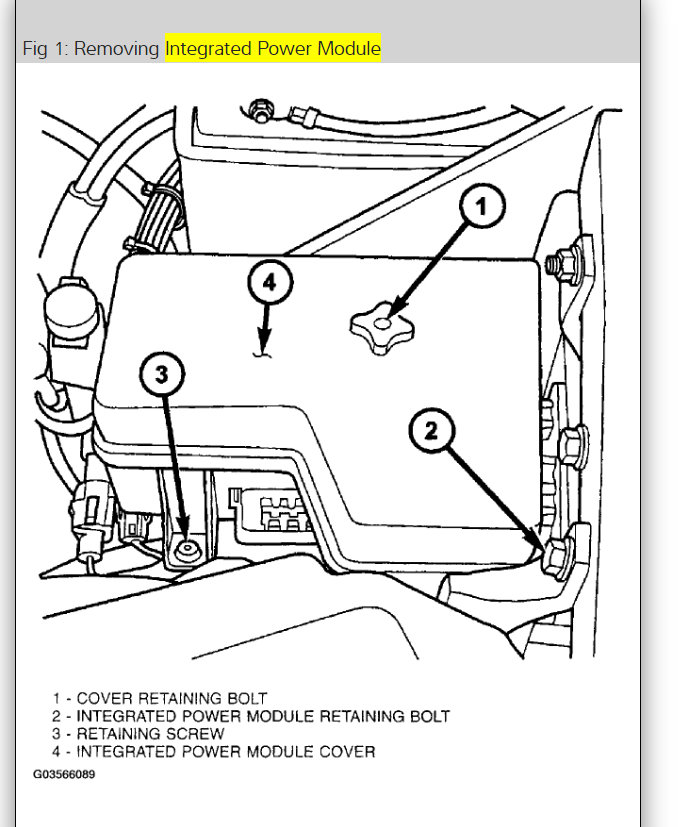

While driving, my trucks engine will suddenly just shut off. It does not sputter, it just simply "turns off". I can restart it right away, and it seems normal.
Friday, February 19th, 2010 AT 8:15 PM
KEN L
  • MASTER CERTIFIED MECHANIC
  • 48,345 POSTS

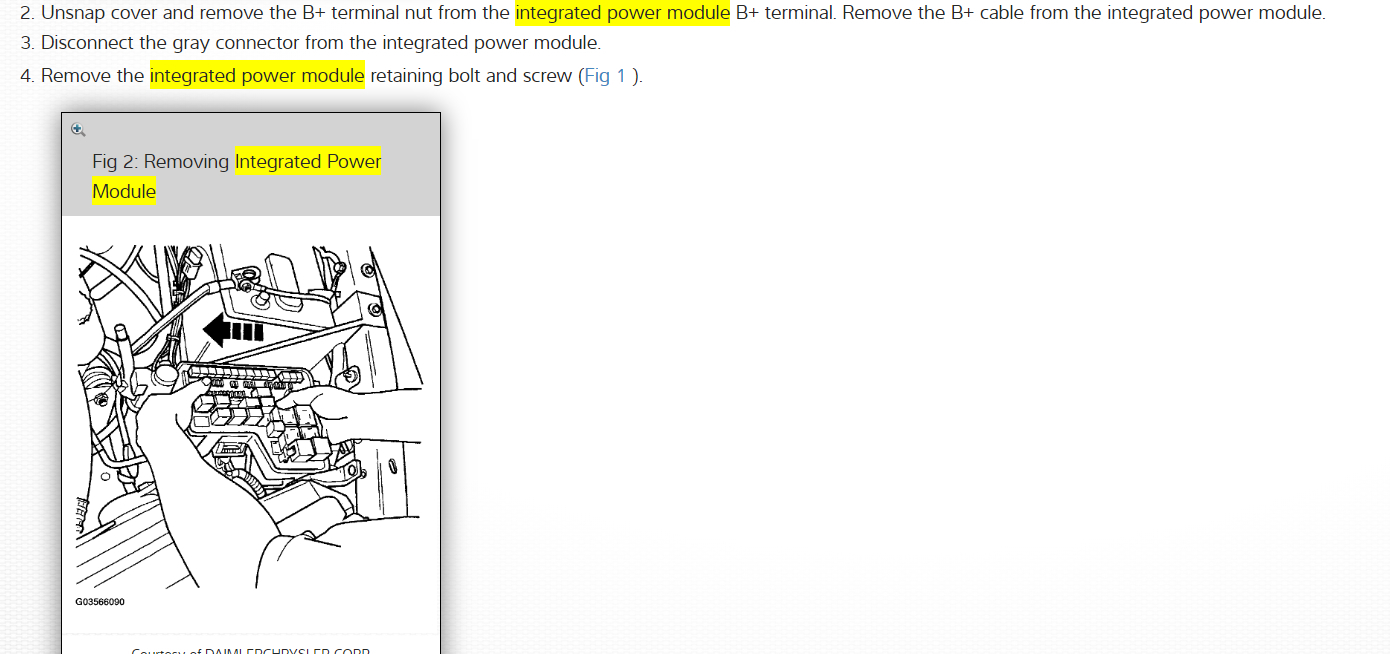

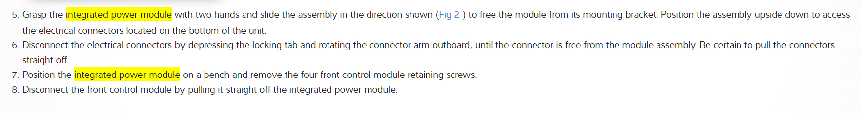

I have seen the TIPM go out and cause this issue, but we should run the codes first to see what comes up. Also, I have left the replacement instructions in the diagrams below for the TIPM replacement. It won't leave any codes when this is bad, but it is easy to replace because it self-learns.
