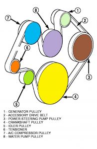

What tools do I need to change the serpentine belt? Level of diffifulty??

Locate the belt tensioner pull away from the belt remove belt
https://images.2carpros.com/forum/automotive_pictures/99387_1500_1.jpg

i would rate it a 2 on a dificulty scale, of 1-10. you will need basic wrenches to move the automatic tensioner to loosen up the belt. two people work best with this.
the hardest part is making sure all the v groves are lined up with the pulleys so it doesn't shred.
