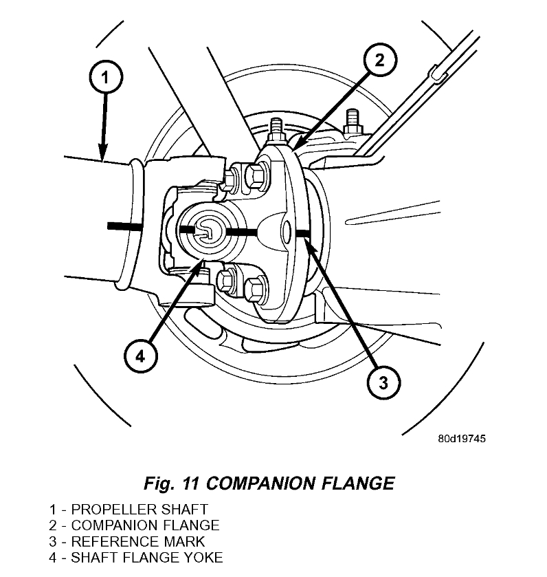

2003 Ram 1500 4X4. "Clinking noise, "that you hear when next to a curb or on street where cars will resend that sound to your open window. Rear Left side. "" Tick tick tick"". Checked brakes. All good. Backing up noise gets louder. Forward and it basically quiets down to that tick, tick. Been doing it for 6 months. And hasn't really gotten any louder.? Fluid level is good, But needs changing.( Note: positrac, antislip rear end.)
Friday, July 14th, 2023 AT 9:14 AM

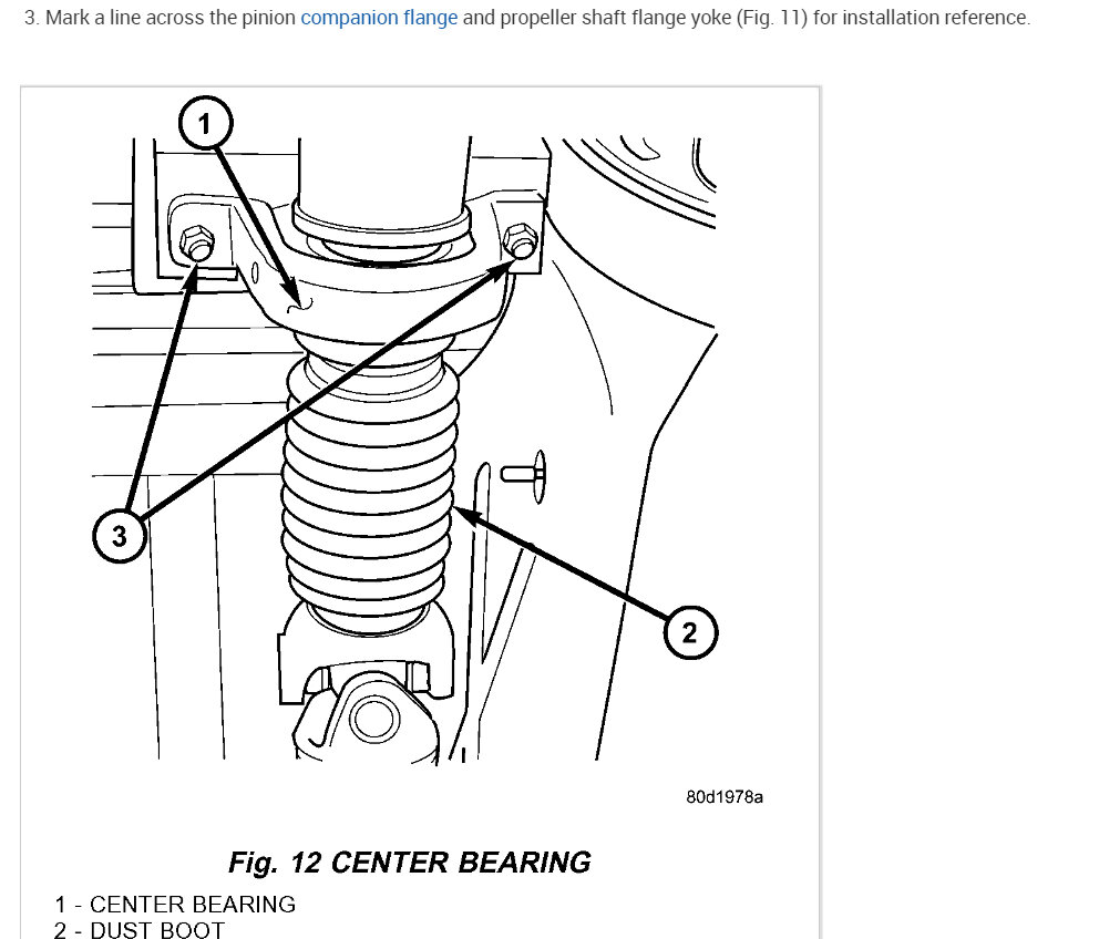

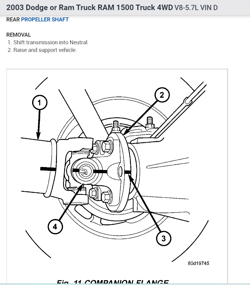

KEN L
  • MASTER CERTIFIED MECHANIC
  • 48,363 POSTS
I would stop driving it because it sounds like the U joints are out and the driveshaft could come loose and cause damage. Use a flashlight to inspect the U joint and look for rust colored dust.

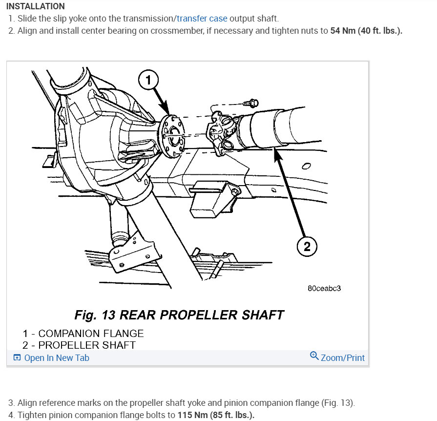

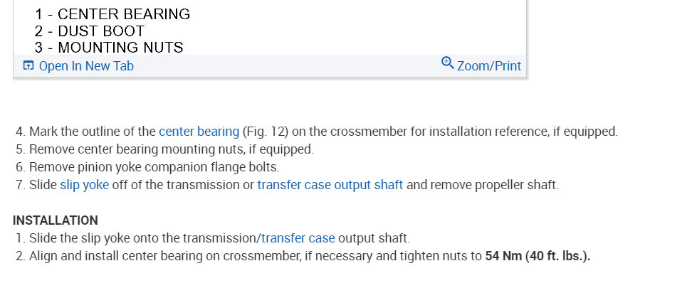

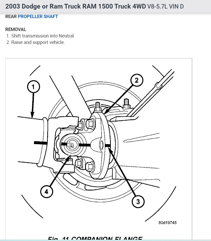

Here is how to remove the driveshaft in case you need to remove it to replace the U joints.
-1
Friday, July 14th, 2023 AT 9:50 AM

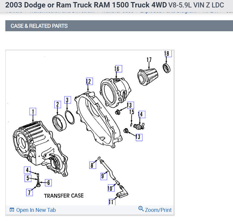

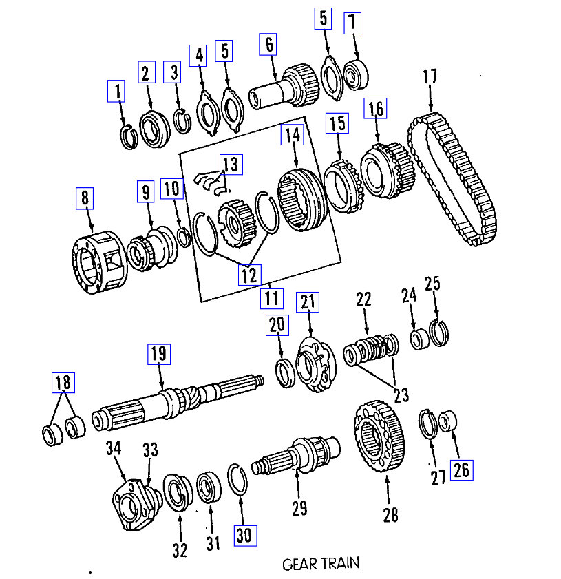

After further research I discovered the Front Driveshaft is wobbling where it enters the transfer case. It is the source of the "tick, tick" noise. All u joints are seemingly in good shape. Never removed this front shaft. Looks as if the exhaust cross over pipe might restrict a smooth change out. Tell me about the nose shaft entering into the transfer case. Is there a seal? Manually twisting shaft results in a rattle at entrance to Transfer case.
Sunday, July 16th, 2023 AT 11:51 AM
KEN L
  • 48,363 POSTS
It sounds like the transfer case is having a problem or the U joint is locked up which it could still look good. I would remove the shaft and manually move the U joint to check the operation. If it is okay, then for sure the transmission case will need to come apart for inspection. Check out the images (below). Let us know what happens and please upload pictures or videos of the problem so we can see what's going on.
+1
Monday, July 17th, 2023 AT 10:22 AM
RICHARDONZELLE
  • 12 POSTS
After even more research, I have determined that the carrier bearing in the front drive shaft of the Dodge 2003 Ram 1500 4X4 4.7 is apparently the culprit causing the noise and vibration. I researched YouTube to change the bearing out and discovered that my little back yard shop will not get the job done. I can purchase a used front drive shaft with less than 100,000 miles on it and consider this my quick fix based on my budget. Will pray that it will hold out until payday. I will do the change out. Will let you know the results. Thank you.
