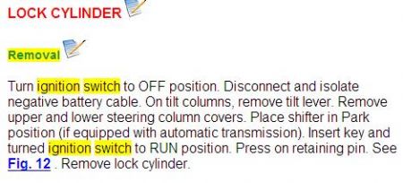

I HAVE A QUESTION IN REGARDS TO MY INIGITION SWITCH. I NOTICED THAT IT'S BEEN HARD THE LAST COUPLE OF TIMES TO START MY TRUCK. THE KEY DOES'T WANT TO TURN. COULD IT BE THE KEY? SINCE THE VEHICLE IS SIX YRS OLD. COULD IT BE THAT THE INIGITION SWITCH GONE BACK AND WON'T ALLOW THE KEY TO START. ANY HELP WOULD BE APPRECIATED. THANKS IN ADVANCE

Have you tried a different key? Remove the lock cylinder and check it out.
https://images.2carpros.com/forum/automotive_pictures/170934_dodge_lock_cylinder_1.jpg
